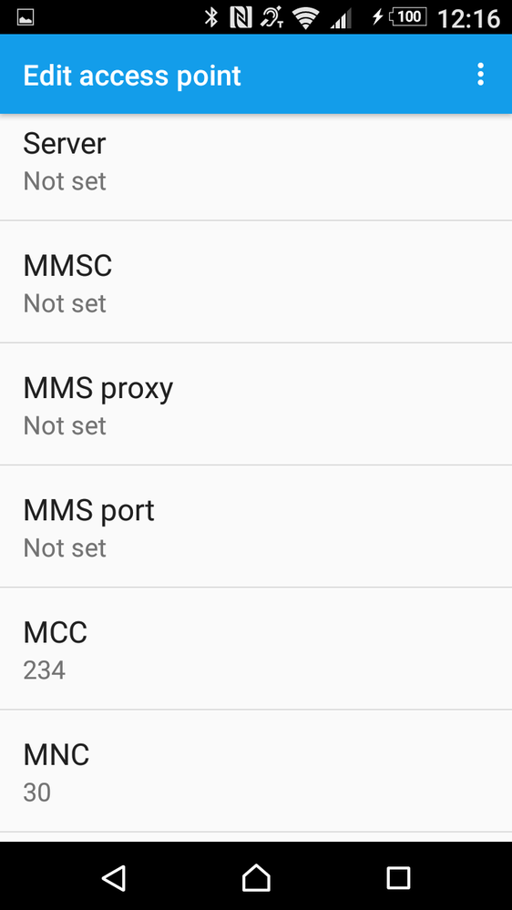

01-04-2021 04:22 PM - edited 01-04-2021 04:25 PM

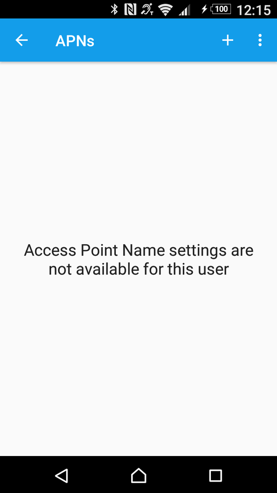

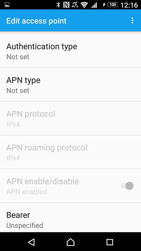

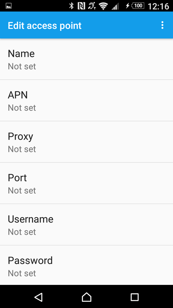

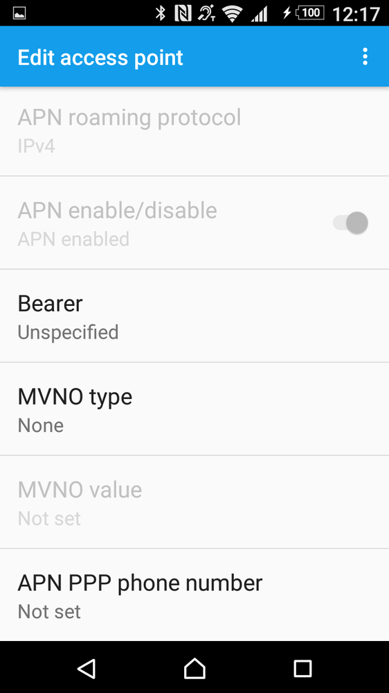

The APN looks completely unset. At least the Username & pwd are missing. That's why you can't use data.

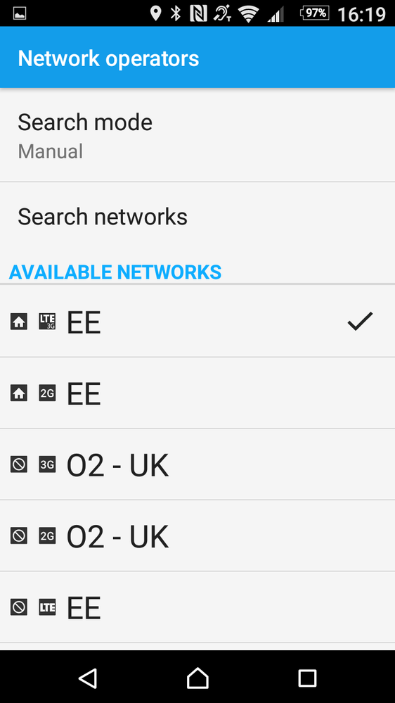

Reboot the device & then do a manual search of Network Operators & select EE. Repost that 1st proper page of the APN.
About 3 months ago were you using it with another network? Maybe it didn't switch back to EE properly.

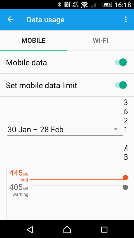

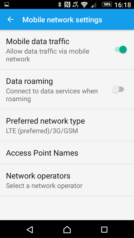

31-03-2021 04:34 PM
I have Data enabled, EE Network is available, Phone data Limits within the parameters.
Prior to this problem, if I was not connected to Wi-Fi the phone auto switched me to Data. I also checked if I need to set APN, but I do not think I do.
Data Enabled
Network Available
Data Limit set within allowance

01-04-2021 12:46 PM
@XRaySpeX Hi again. So, I have a part time job which involves occasional travel across the UK. I want to use data to pick up any emails or check bus or train times. When at stations and on some bus journeys I usually get Wi-Fi. Often there is no Wi-Fi so Data is a great help. This used to work fine up until December.
You asked to look at APN. Here are 5 screenshots:
1
First APN screen
Then I click the + icon and the various fields for APN display over 4 pages that follow:
2
APN first section
APN second section
APN third section
APN fourth section (bottom)
Sorry this is long winded, but any ideas would be great to hear.
