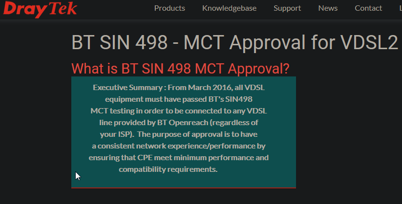

But I entirely discounted those firmware versions because of https://www.draytek.co.uk/information/our-technology/bt-sin-498

Vectoring has nothing to do wiith the ISP It has everything to do with Openreach and as I mentioned earlier is only implemented on a small number of BDUK funded cabs.
2021-07-28 20_00_12-BT SIN 498 - MCT approval for VDSL2 — Mozilla Firefox.png
Please note the "regardless of ISP".
