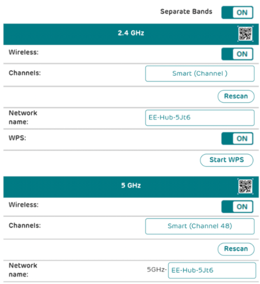

Post the Advanced / Wireless Settings page.
@XRaySpeX it says there should be 2 separate channels but I can only find the 5ghz one, any ideas?
XRaySpeX
EE Community Star
EE Community Star
Both bands are switched on. So I see no reason why your devices & WiFi Analyser apps don't see the 5GHz band unless that band is faulty in the router.
