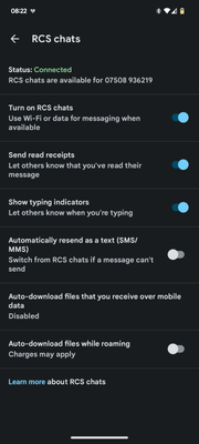

16-08-2024 08:54 AM
Port was complete yesterday as per message from EE. RCS still is logged in as the number EE issued. Have been through many loops of uninstalling app and turning on and off again.
That is the number EE issued.
Disappointed as I've signed up for 24 months and been provided with a service that isn't good enough.
