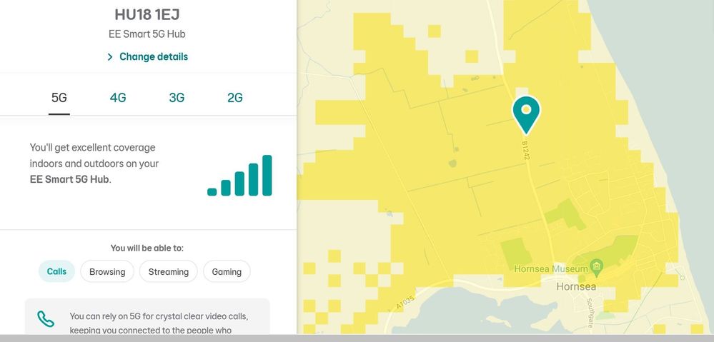

@archercj wrote - Another neighbour was also told from EE that they are investing in 5G in the town about 15 miles away.
According to the EE Coverage Checker, there is an EE Mast very close to you (HU18 1EJ) that is providing good 4G and good 5G Coverage in your Area (See the 5G Map Pic below), looking at the Area I would hazard a guess that the 5G Signal is going to be either 5G Band n28 or n1, either way its not a Signal that you will pick up using your older 4G Setup.
Maybe its time to think about an Device Upgrade, your Archer 4G Router is a Cat6 spec, Most 4G/5G Routers these days are up to Cat22 now, plus they cover most of the newer 5G Bands (on EE currently n1, n3, n7, n28 and n78)
