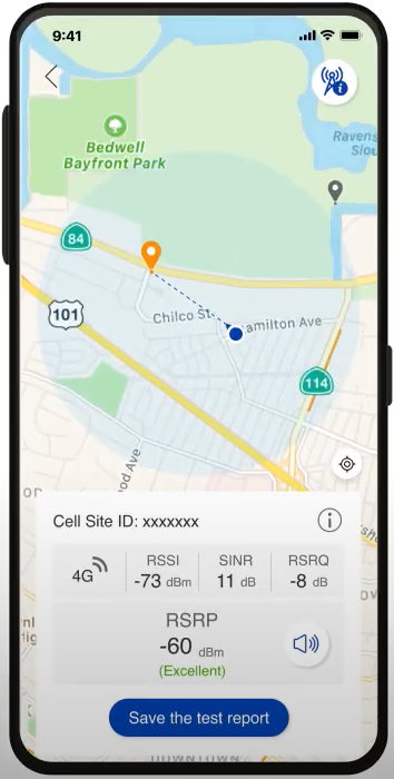

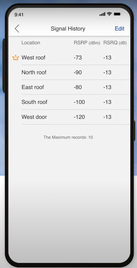

@BoltonSailor looks like that Web UI is well locked down, no mention of RSRQ or SINR which are really handy measurements, the RSRP is good Info, RSSI doesn't really tell you much on LTE Networks, more importantly those vaulves shown are for the 4G side, no Signal Info on the 5G sadly, I know there's a 5G Signal Bar up the top, but that is just effectively a Pilot Light to tell you there's 5G in the Air, that will not confirm whether you are actually have a Data Connection to a 5G Signal.
On the Cell Site Info, sadly I cannot track the CID, I really need the eNIB of the Site, or you could always PM me the Site location, or a Post Code that is close to you.
Sad the LTE Ally didn't work, you could try it again and if it lets you select the NR5101 Router over the EE NR5103 (pretty much the same Device.
Another one you could try is Zyxel Air App (try the NR5101 it might connect, but check the Web IP) the Air App also looks like it contains some good Signal Info.
On your very last Post re the Cable swapping, Im just about to walk out the Door so I will absorb that info later.
Below some Screenshots I took of the Air App -
