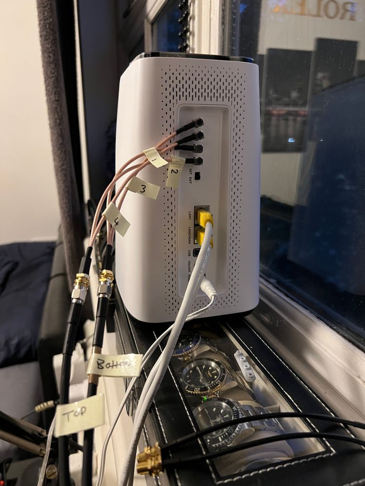

Ok so I got home and played around with the order and patterns of the wires and also the INT AND EXT switch on the back.
let’s start with the switch on the back of the ee 2021 5g router.
with no antenna connected on external setting I got 105mbs down and 3.91mbs up
with no antenna connected on internal setting I got 363mbs down and 31.2mbs up
bare in mind this is all with the router by the window with the fake Rolex watches ( the router can hopefully move to its desired place once I get passed the trouble shooting stage which I’m confident we will.
I just read the parts where you said not to use the 1 to 2 adapters, the crazy thing is out of the many speed tests i just completed with the many different combinations that 1 to 2 setup is getting considerably faster speeds. However I’m definitely going to remove them and do a few more tests with the single adapters now that I’ve worked out which order gives the fastest speeds.
replying back to the person I was chatting to earlier I can provide confident feedback that ports 3 and 4 (the bottom 2 ports) definitely  give me double the speeds. I switched to the single SME to TS9 adapters and the results are as follows:
1 & 2 got 15.7 down and 28.2 up
1 & 2 with wires flipped around increased to 200 down and 61 up
3 & 4 got 200 down and 60 up (kept the main wires how they were)
this is where it gets mind boggling.
I switched back to the 1 to 2 adapters and was shocked at how much faster the speeds are.
Im talking about 450mbs down and 70mbs up
see photos below.
And
I’ve spent about an hour messing about with all this and as it stands the split cables shouldn’t be getting faster speeds but they definitely are.

Thanks for the update.  I have to say it's pretty confusing understanding the various connection combinations you've listed now, but it's clear you're getting better speeds with the splitters and I would be very happy with that performance.  EssexBoy clearly has a view on the splitters, but evidence seems to be suggesting otherwise.  (No disrespect EssexBoy!)
I think you're saying that with just the two wires from the antenna, you got a massive speed increase just swapping the wires round when connecting to ports 1 and 2 which was about the same as connecting the two wires to ports 3 and 4.  I don't understand what you mean by (kept the main wires how they were).  Thanks.

in regards to to what I wrote previously.
I tested the single SME to ts9 adapters for you to see how the different ports perform.
I plugged the first cable with ts9 adapter in to port one and then the other in to port two and got the terrible speeds of less than 20mbs down which I mentioned.
I thought that can’t be right so I swapped the wires around, putting 2 to 1 and 1 to 2 (just flipped them around still using ports one and two only)
soon as I flipped them around I immediately got around the 200mbs down region.
so that’s when I realised the two cables coming from the antenna definitely make a difference which order you plug them in. Which is why I’m my photo you will see I labelled the two main cables as top and bottom as the port configuration is vertical so it’s easier for me to remember.
so moving on the the ports 3 and 4 I kept the same order as the better speed I achieved from 1 and two and just plugged in to 3 and 4 and sure enough the speeds was in the 350+ range (still not as quick as the 1-2 adapter I used.
If you are still confused just use port 3 and 4 do about 5 speed tests and then swap 3 with 4 and do another 5 speed tests. Which ever gives you the beater speeds stick with that.
