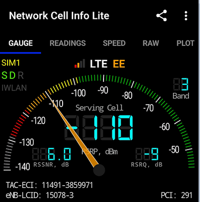

its really strange because i could get 100mb on 4g on my galaxy fold 4 but now days signal is mainly RSRP -115Screenshot_20230705_180317_Network Cell Info Lite.jpg at best
strange this has started hapinging since march when i renewed my phone subscription (Sure this is just coincidence) :¬)

So this is why i am asking here and why i added image of my tower and signal which is very poor

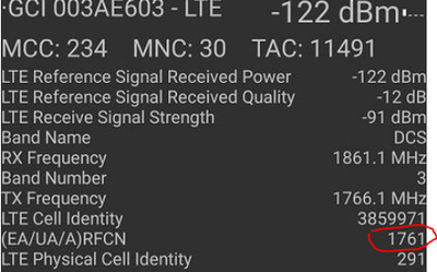

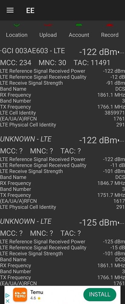

EE use Bands 1, 3, 7 & 20 for 4G services, in your screenshots above you're connected to a Band 3 carrier. The EARFCN is a channel number within that band, and on the eNB you're using - this will likely be 1617 or 1761.
That site doesn't appear to have any other bands in use, so to further diagnose the cause of your issue would need knowledge of which band/eNB (site ID) you were connected to previously.

info derived from "Network Cell Info" and "Cell Mapper" apps
i am connected to the same tower/repeater i always did
It uses Band 3 and 1761

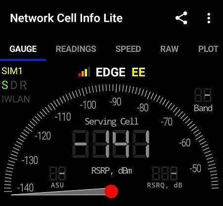

Well its finaly got so bad i have no signal in my me14 home and if i go out side i get 1 br but mostly nothing
I have reported it but where will that get me - ahh another 48 hour possible reply
web site says everything fine move along nothing to see here
asked a few neighbours they are getting low signal but they use landlines and EE mobiles for emergencies
Used to be SO GOOD here now its pants hehe
