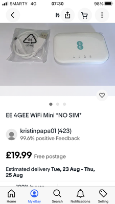

Hi Chris. Very useful information. Thanks for that. I’ve obviously been retired too long and not kept up with specs. I saw this on eBay. Does this look OK? Not sure what CAT this would be. If so, will buy. I can sell on the TP-Link.

Sorry. Picture was taken down. The one I saw was an EE 4G Wi-Fi Mini. It’s a white box. He’s sold loads. Thanks. Rob

The 4GEE WiFi Mini mobile router is fairly up-to-date. I'm not au fait with mobile CAT nos.
It's probably similar in functionality to the TP-Link M7350 but may not be as configurable. The DHCP on the 4GEE WiFi Mini is not user-configurable.
Many thanks for that. Not worried about DHCP. Just like to work with the new EE sim out of the box. The TP-link is really hit and miss. Mostly miss! For £20 I’ll give it a try. Thanks again
Cant see the Picture as it needs Admin / Mod approval.
The Minis normally have a lower Cat spec over the normal 4GEE's, but as said cant see the Pic yet.
