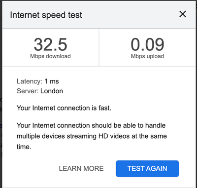

I’ve been with EE for some time now and while the service has occasionally been patchy for a day or two, over the past month it has become close to unusable. We are using the Smart 5G Hub, while download speeds are generally strong (between 30–100 Mbps), upload speeds are consistently slow, typically between 0.01–0.1 Mbps.

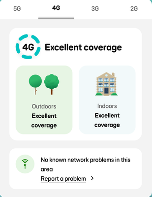

We’ve tested the router in various locations around the house, turned off 5GHz, disabled 5G (running solely on 4G), various combinations of all of these, and haven’t seen any improvement. At this point, the connection is so unreliable for every 30 minutes of use, we’re experiencing around 15 minutes where websites and video calls simply won’t load.
I’ve attached a few screenshots which I hope are helpful. Any thoughts, suggestions, or fixes would be greatly appreciated.
