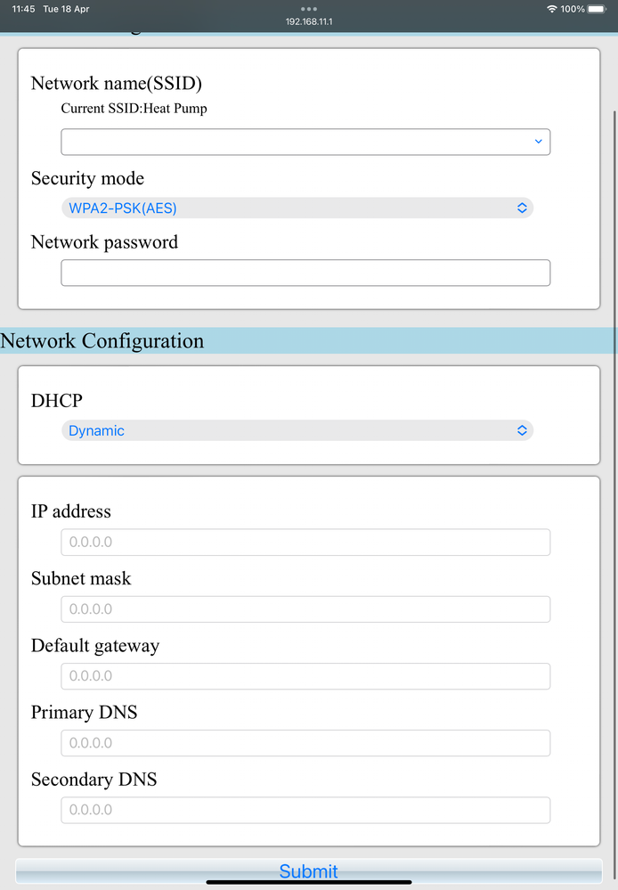

Hi James thanks for the welcome. No sadly not much detail other than they said EE mobile broadband was known to cause compatibility issues with their heat pumps. Didn’t sound as though it had been explored any further than that. This is the setup page for the heat pump dongle. I’ve changed the SSID of my Wi-Fi to ‘heat pump’ to separate the 2.4ghz bands out as I know it needs that
