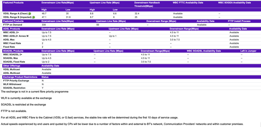

I followed the BT Wholesale broadband checker and the upload speed is still too low for my needs:
