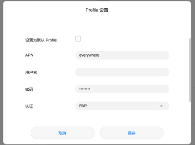

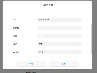

I can use 5g cpe to surf the internet and view all the information in the discord channel, but I can't join the voice channel. Steam also shows no connection.I saw a forum that asked me to set ipv6&ipv4 to ipv4 only. But after I set it up, the 5g cpe could not connect to the network directly.

delete the username and password still not working,my 5g router is 5g cpe pro 3

It is 100% an issue with the use of the IPV6 layer, and switching to IPV4 only should allow it to work but I'm not familiar with the router you're using and why it would not reconnect.
Could you try to reach out to the manufacturer to see if they have any ideas on how to get this to work?
Copying the details from the Default profile and changing that one setting should not cause it to refuse to connect.
