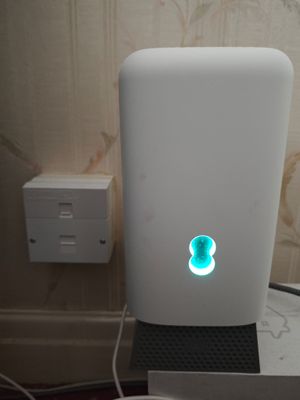

the main telephone socket, it has the extra part that connects to it, separating the connection for the phone and fibre broadband.
the EE router is connected to a different socket that they installed, similar size but with flashing lights.
the issue is not with the wall sockets but with BT and EE, broadband was moved over fine, the telephone however wasn't. like I said, there is a dialtone on both the original telephone socket and the EE router, when making calls on both sockets the landline number comes up

Yes, that's a landline phone socket from which you are getting an analogue landline signal, which you you shouldn't do if you have DV. It should be dead when you have DV. In my view the system is getting confused between them when somebody dials your no, (which you still retain).
