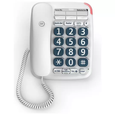

You can still have everything phone-wise to be connected through cables, by buying normal analogue corded phones such as the BT 200 Big Button Corded Telephone
