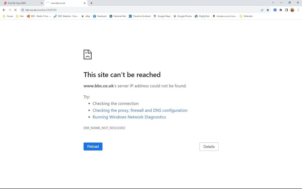

What is the exact wording of this DNS error msg?

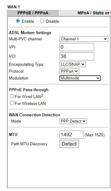

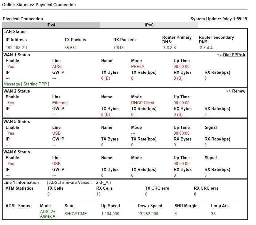

here's a few more screens
2866ax_adslsettings.jpgdns errordns erroronline status - ADSL connectedonline status - ADSL connected
In 1st screenshot what does "Multimode" drop down into?

The Encapsulation Type should be VC Mux.
Multimode is the Draytek recommended setting.

Here's the modulation options - no vcmux as such, but it has connected the ADSL line so the auto option must be working.
Still getting dns errors
What about the Encapsulation Type options?
Does that not have VC Mux as an option?

You problem is, as @Mustrum  nicely spotted, that Encapsulation Type should be VC-Mux, not LLC that you have. It was stated in the article that he gave in the 1st reply to this thread but you felt it was lacking in detail

@Mustrum  @Xrayspecs I did a bit of investigation yesterday and discovered an option to force use of a specific dns server.
This has worked and now the router consistently goes to the google servers 8888 and 8844.
However , still getting same error - no access to any site.
