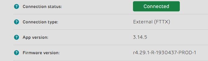

At last! The issue is solved for the 7 Pro!
@imacken Thanks for posting up, will add the 7 Pro version to the new list. Will also just use today's date as you are the first to post it change wise.👍
FW: r4.29.1-R-1930437-PROD-1 and the gui is at App Version 3.14.5 27/07/2026
