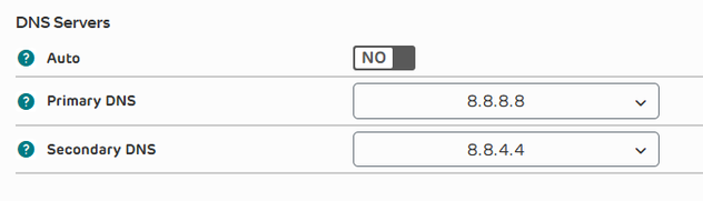

Parental controls is implemented differently depending on what hub you have; the older hubs (e.g. Smart Hub 2) seem to use 'basic' DNS filters, whilst the newer hubs (e.g. Pro) are doing something a little more 'intelligent'. Given you can't get into the app to check the intelligent bit, then here's an idea...
If you have a Windows machine that's affected by the problem, try opening a command line window and carry out some DNS lookups to a few of the sites that you're struggling to get to, e.g: -
> nslookup reddit.com 81.139.56.100
(replacing 'reddit.com' with any address you're struggling to get to - but keep the 81.139... IP address at the end).
After pressing Enter, a bunch of IP addresses will be returned e.g. for Reddit I'd expect to see 151.101.x.x IP addresses. If you see something else - specifically a BT-owned IP address - then it's a pretty decent indicator that the DNS parental controls are getting in the way.
If the above suggests it is a parental controls problem then one way you might be able to work around it is to change the DNS server addresses being dished out by your Pro.
  • Navigate to the Hub Manager at http://192.168.1.254
  • Once you've accepted the security warning etc. navigate to Advanced Settings > My Network (you'll be prompted for the hub admin password)
  •  Select the 'IPv4 configuration' tab
  • At the bottom of the page there's a 'DNS Server's section. Flick the toggle to 'NO' and enter some DNS server addresses that aren't EE's e.g. below I've used Google DNS: -
  • Save the changes
  • Give the hub a swift reboot and see if it's helped
It's a bit of a 'hacky' solution to your problem but it might help alleviate the hassle whilst support are looking into whatever is wrong with your account.
