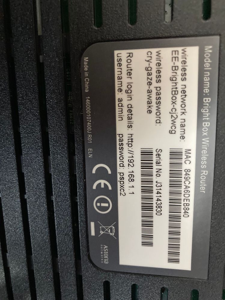

01-03-2023 04:15 PM
Yes there is also a modem. All components are as-installed by EE. I don't know what model the router is, where would I find that out? Serial Number: J314143830
01-03-2023 06:24 PM
Read it off the label on it. Also post an image of it.
Why do you need to use a modem? Have you ever tried connecting the router directly?

02-03-2023 10:39 AM
@frankmarshall yours is just a very old installation, from the early days of FTTC where throuter used at that time did not work for VDSL lines, so Openreach installed one of their modems. More recently ISP's have provided a combined ADSL/VDSL router for customers to self install.
You can normally negotiate a new router when you recontract with EE, the ones on offer now have dual band Wi-Fi and they don't need that Openreach modem you have, they also offer more diagnostic information.
If you give the Broadband Care Team a call they should be able to sort you out a new router, you may have to pay the postage, but do not get talked into paying the full price!
HTH
