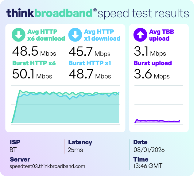

Speed test through ethernet connection result: https://www.thinkbroadband.com/assets/speedtest/1767880008562554855.png

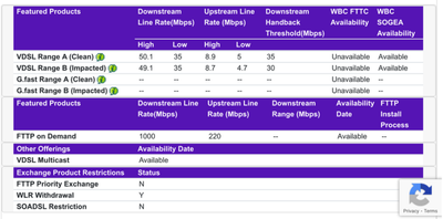

Please use the Address Checker for the BT Wholesale Checker.
Apologies XRaySpeX, here they are:
[image edited to remove top line]

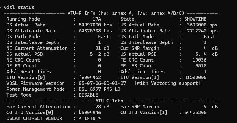

Hi
I have a Master Socket 5C, so have done as advised. No wires connect to back of the faceplate and there are no extensions in the house nor any phone plugged into the Master socket.
Stats after reboot with modem connected directly to the Master socket with a filter. Second one shows up time of 2 minutes. No change to sync rates.

 Thanks for the tip, but I just double checked and my address is not listed on the BT check I posted. It just said ‘address’ and the town I live in.

Hi @JMW1970
I believed a house number was showing and I removed this to be safe, if you can add this again and remove the first line above the box so no details are showing this would be great. If this was not your address details, I am sorry you can upload this again 🙂
Edit: I have added this image back now as no address details were showing and apologise for any confusion.
