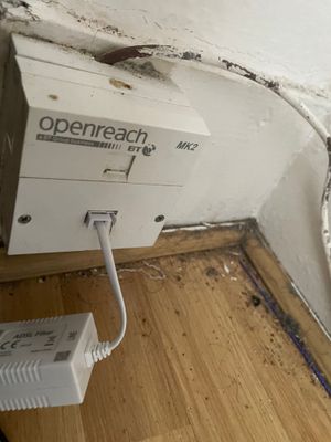

Thank you for your help, today they said the service is ready and I plugged it into the openreach box. but the box seems cannot function anymore. and it is keeping flashing orange lights.
what should I do ?

@noarijwqk2isk2 What openreach box are you plugging it into, does it have any lights on it! While your picture clears copy off the electronic version to connecting up a router!

 It looks like tthis and Seem doesn't work anymore
@noarijwqk2isk2    so what did customer services say?
You could remove the two screws on that faceplate and plug the filter into to the hidden socket  and see if that helps.
But given its age the chances are it will need an engineer to check the line is still connected.

@noarijwqk2isk2 If you cannot follow the connection diagram on the copies link's etc then you have the cable plugged in the wrong place, using the wrong connection to that socket! Dual socket top connection straight in small RJ11! See page 1 that @Mustrum supplied to you...
@Mustrum Still cannot rule out if OR have connected them up yet, but at least they will have the fighting chance wiring if the connect it in the right place! After that then down to OR for testing!
Take the cable that comes from the router & is plugged into that dangly DSL filter out of the dangly filter & plug it instead into the top socket of that BT socket box.

She has two sockets going to the apartment. One is fibre with G.Network and the other is the BT line.
She's plugged the EE router to the BT line (top port) and it's still not getting a connection. I doubt it's live 😄
I've never really used fibre at an apartment before so sorry if my knowledge is wrong. From what i know with the package she has she will need an ONT box. There isn't one at the apartment but from reading this thread it seems the Nokia can act as an ONT? Is that correct?
If so if she uses RJ45 to connect to the Nokia device do you think it'll work? I'm not sure if it just works like that 😄
