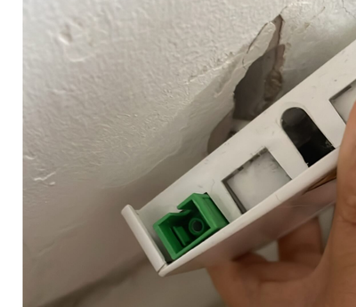

The problem is the wall socket only has a fibre port and no PSTN port, so I can’t connect my broadband line.
on 15-07-2025 11:08 AM
@noarijwqk2isk2 are you able to post a picture of what the fibre port looks like?
Also as per first question, what router and broadband service have you ordered?

on 15-07-2025 11:28 AM
on 15-07-2025 11:29 AM
@noarijwqk2isk2 is that an Openreach ONT?
https://www.bt.com/help/broadband/whats-an-openreach-modem-ont
on 15-07-2025 11:30 AM
no
on 15-07-2025 11:32 AM
i think I ordered the wrong router, can I get a fibre one instead of a smart phone one
on 15-07-2025 11:35 AM
the only different is the cable.
If you have fibre you need an eyjernet cable between the Openreach ONT and the router.
https://ee.co.uk/help/broadband/getting-started/set-up-guide/ee-smart-hub-plus/set-up-full-fibre
