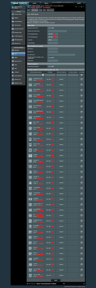

@sedling See attached screen capture when approved for viewing.
Asus DHCP Static Lan assigned.Asus DHCP Static Lan assigned.

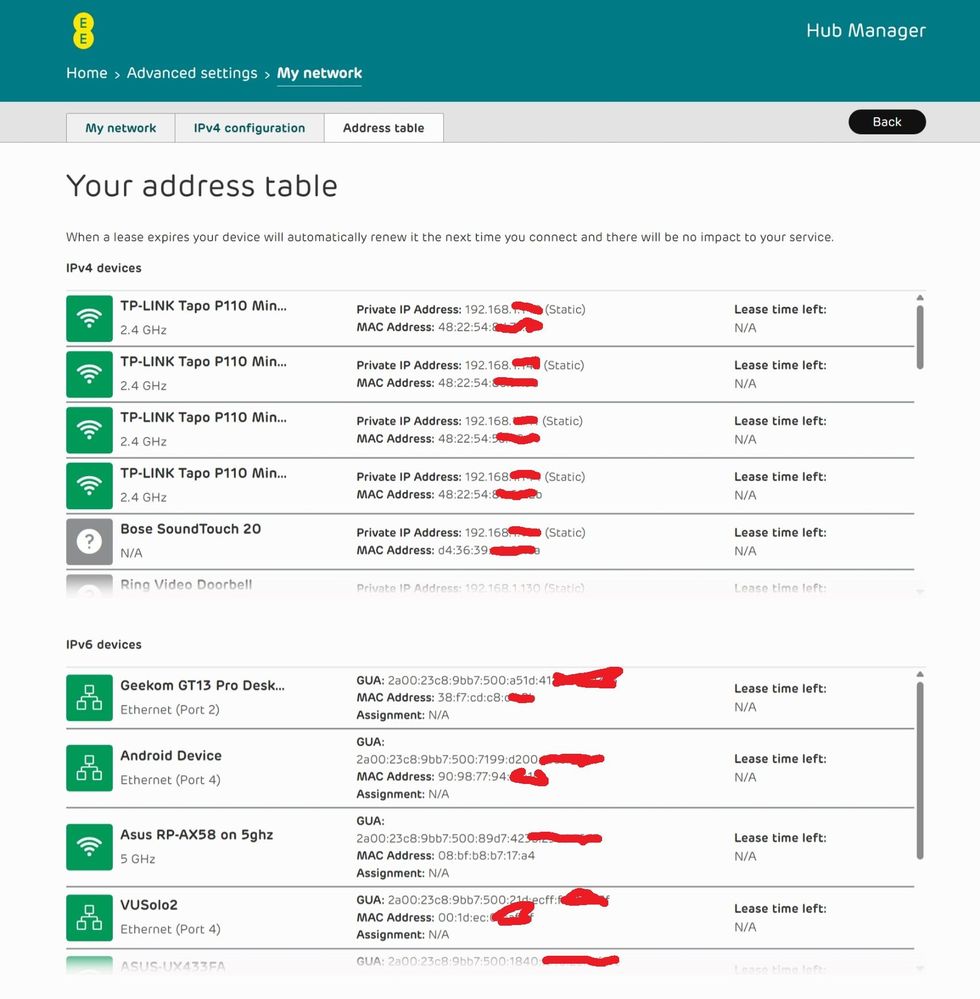

@sedling Also one EE attached but as i say was 6+ at the time. Has to be approved also before you can see it.
EE 6+ 18 months ago.EE 6+ 18 months ago.
