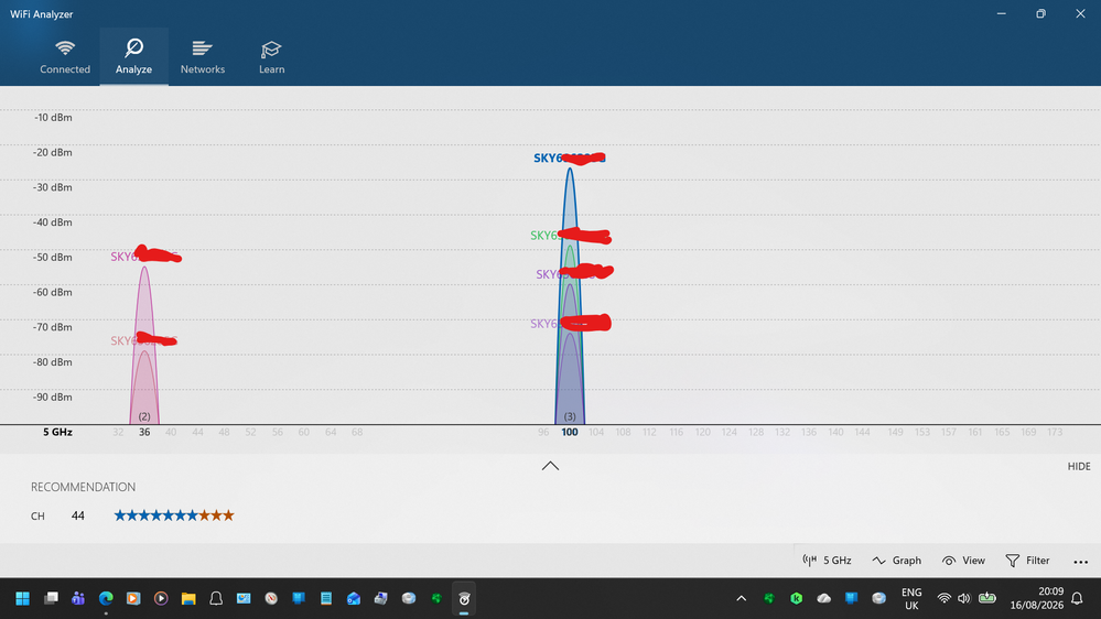

Thanks Jim. I've now got WiFi Analyzer running and this is the current healthy state.
The hub has moved itself back to channel 100 since the restart and is currently working normally. The analyzer shows the main 5GHz BSSID on channel 100, centre channel 114, using 160MHz width, with my phone connected successfully at around -63dBm.
I've also confirmed that both the Intel AX210 desktop and Intel AX200 gaming laptop are currently connected successfully on channel 100 as well.
So channel 100 itself clearly isn't inherently unusable by the clients. If the fault returns while the hub is still on channel 100, I'll capture this same graph before changing or restarting anything so we have a direct healthy versus failed comparison.
There also doesn't appear to be any significant neighbouring 5GHz WiFi overlapping the 100/114 block in the current capture.
@Mellman Will take a look when your posted picture gets cleared for general viewing.👍 Will also take a look at you Intel's when i get a little time tomorrow, think i also have both those versions also desktop/laptop although will say never ever had an issue whatsoever with them at all. Link below to how the channels look mesh node.
Re: 'Compatible Wifi' issues with new Smart Hub Pro and Smart Wifi Pro - The EE Community

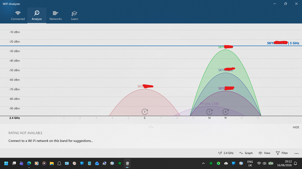

Updated pictures when cleared for viewing. Low value Tp is the next door neighbour's normally he has it on 40Mhz wide channel and it is on Netspot Channel 5 to 11, what can one say? To low to bother anything for me....
2.4Ghz setup. Channel 1 is in use just too far to show up the connection.2.4Ghz setup. Channel 1 is in use just too far to show up the connection.5Ghz setup, CH36  80Mhz CH100 160Mhz width's.5Ghz setup, CH36 80Mhz CH100 160Mhz width's.
@Mellman Picture cleared and looks good, strength matching in your wifi6 bars about correct as well with one bar dropped.

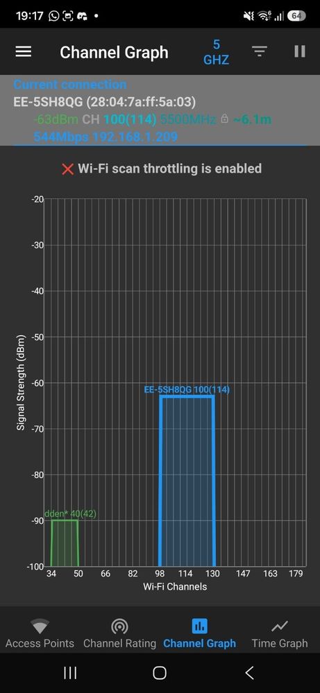

The fault has actually reproduced again this morning on the replacement Smart Hub, and I have managed to capture considerably more information while it was live.
The EE TV Mini started having the same guide/interface connectivity problem again. At the same time my desktop, gaming laptop and phone had all ended up on 2.4GHz, despite the Hub Manager still showing 5GHz enabled on Smart Channel 100.
Using WiFi Analyzer on the phone, the main 5GHz BSSID 28:04:7a:ff:5a:03 was still broadcasting on channel 100(114), 160MHz, at a strong signal. Windows on the desktop could also see the same 5GHz BSSID at around 70 to 82 percent signal.
I then restricted the desktop Intel AX210 to 5GHz only and attempted to connect. It could see EE-5SH8QG on channel 100 but could not establish a usable connection.
I generated another Windows WLAN report during the failure. There were repeated association attempts which ended with:
"The driver disconnected while associating."
One manual attempt also ended with:
"The specific network is not available."
This was despite the same scan still showing the 5GHz BSSID strongly broadcasting on channel 100.
