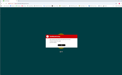

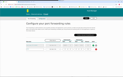

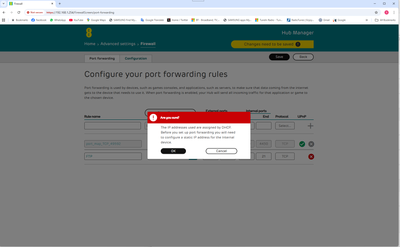

Hi, My EE Hub 7 Plus has now updated to App version:3.11.3, Firmware version: r3.35.24-R-1648110-PROD-84001.  Still cannot get port forwarding to work.  Anybody had any success port forwarding on the EE Hub 7 Plus?  I have done a factory reset and reconfigured port 21.  No success.  There is issues with EE Hub 7 Plus.  what do others think? Got lots of issues trying to update the rules.  I attach some screen shots

@SamyM Have you set that IP as Static in the Advanced Lan settings there is a sample earlier in the posting were all the device are set on Static IP and not using the DHCP server to get once they are assigned. One off your pictures did not get through so you must be showing something like the IP etc.
