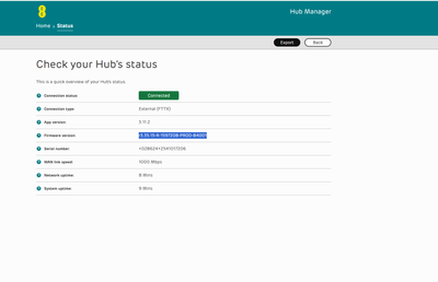

Hi, looking different to mine. I only unplugged my router last week, swapping back to Hub 2.  Looks like they have done another update, as this is mine.

@Pecbeck Seen your message so you are not blocked, and correct about the FW version.
@SamyM As from your posting earlier you have had multiple EE Hubs sent to you, and you are reporting yes you had an update, now your screen capture is showing one version back, leave the hub on at let it do a FW update to the latest, once done power it off for 5 minutes and restart again.

Hi, My router seems to have updated to r3.35.23-R-1648107-PROD-84001 but it seems to need to do another update to get to r3.35.24-R-1648110-PROD-84001 from previous communications. I will leave it overnight and see what happens.
