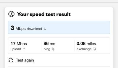

I can show you a speed test I did:
As for doing a wired connection test - I probably could for the sake of troubleshooting. However, I doubt that would change much considering it’s mainly a wireless connection I use and judging by the speed results, I’m uncertain using an Ethernet cable will do anything.

@BandedCrusaider Not sure, your tech log is showing 19.7 up and 3 down, but your speed test is showing 3 down and 17 up,!

23-02-2025 08:50 PM
haha I know right!
it's a shame because the earliest I can get someone out is Wednesday ;(
also the order it shows on my log is 19/3 but my connection status shows the other way around (3/19)

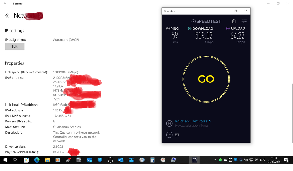

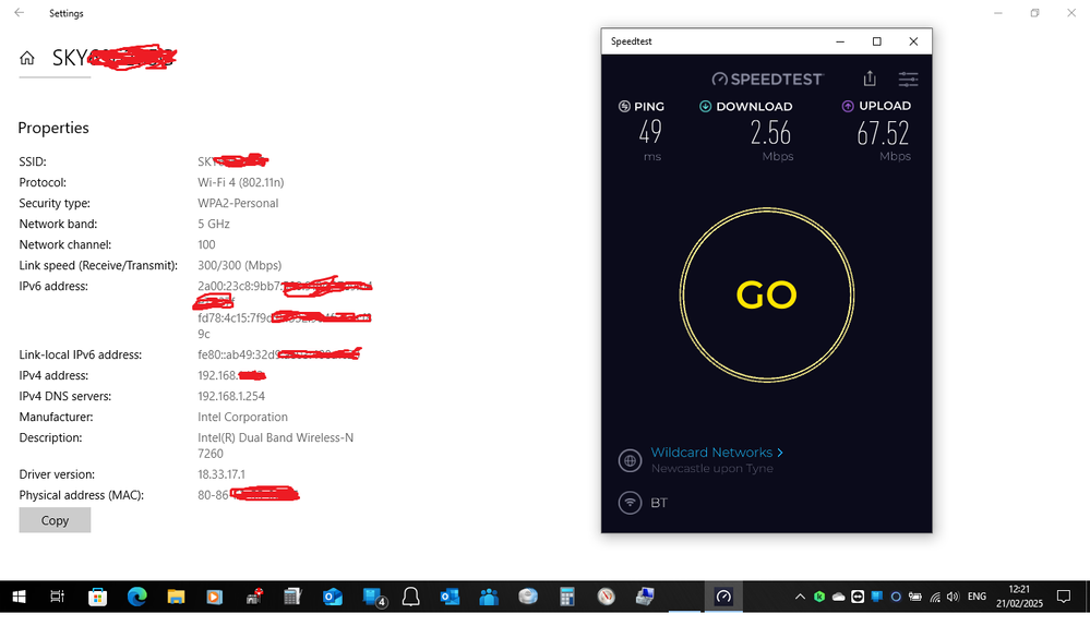

@XRaySpeX Wonder what EE would have to say about the non wired FF500 connection.
EE Smarthub+ SH31B on FF500
And below earlier with Ethernet connected trying to track wireless issue.
EE Smarthub+ SH31B on FF500 Ethernet
