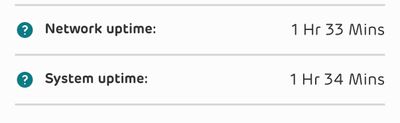

Then that is most likely not your culprit! however, there's been weirder things to happen. Images take a while to be moderated and approved it seems, so can you paste your system uptime here? EE should be able to see the statistics on the ONT from their end if they can access the ONT directly, so if they were seeing LOS surely they'd let you know.

So I tried taking the battery out of the doorbell. I managed two hours. Another restart of the router 5 mins ago
the system and network uptime are 5mins when I log into the router.
