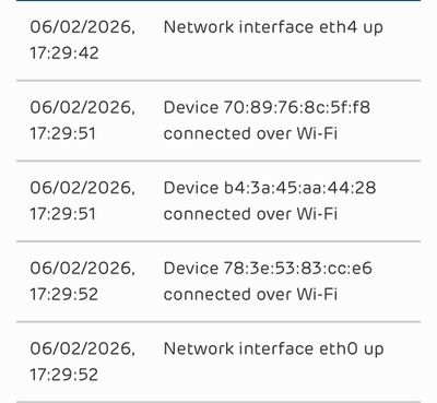

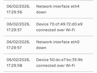

06-02-2026 05:35 PM
it’s just happened again. It always say eth0 and eth4 up and then a few seconds later they are down. Is this the issue? And what does that even mean??
06-02-2026 05:53 PM - edited 06-02-2026 06:02 PM
@maccy20 Cannot go much further with this, is the light Green or Aqua, take a look at the link below!
EE Smart Hub 6 Plus lights | Broadband Help
Below a typical log start up file to view
"Time and date","Message"
"21/09/2024, 07:01:34","DSL connection lost"
"21/09/2024, 07:01:50","Device ??:bf:??:b7:??:a1 connected over Wi-Fi"
"21/09/2024, 07:01:50","Device ??:dd:??:e4:??:80 connected over Wi-Fi"
"21/09/2024, 07:01:51","Device ??:90:??:8b:??:39 connected over Wi-Fi"
"21/09/2024, 07:01:51","Device ??:22:??:8d:??:2b connected over Wi-Fi"
"21/09/2024, 07:01:51","Device ??:22:??:8d:??:9a connected over Wi-Fi"
"21/09/2024, 07:01:52","Device ??:22:??:8d:??:b5 connected over Wi-Fi"
"21/09/2024, 07:01:52","Device ??:22:??:5a:??:f4 connected over Wi-Fi"
"21/09/2024, 07:01:53","Device ??:77:??:52:??:5d connected over Wi-Fi"
"21/09/2024, 07:01:54","Network interface eth4 down"
"21/09/2024, 07:01:54","Device ??:66:??:3c:??:58 connected over Wi-Fi"
"21/09/2024, 07:01:54","Device ??:bf:??:b7:??:a4 connected over Wi-Fi"
"21/09/2024, 07:01:56","Network interface eth4 up"
"21/09/2024, 07:01:58","Device ??:66:??:3c:??:58 connected over Wi-Fi"
"21/09/2024, 07:01:58","Device ??:36:??:c0:??:ea connected over Wi-Fi"
"21/09/2024, 07:02:02","DSL connection established"
