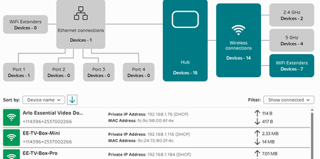

The Arlo doorbell appears to be connected to the EE extender at the time this screen grab was taken. It does not appear on the network at all right now. The Arlo chime device is one of the 2.4 GHz devices.

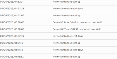

This is the log for early this morning. I do not have the expertise to interpret it:
@VT01 While your posted pictures take time to be cleared for viewing, is the Extender working and also showing as connected, lose the Extender you will lose the Arlo doorbell.....

What is connected on the Ethernet port going up/down like a yo-yo connection wise? Two devices on wifi either dropped or connected at the 3.28 and 3.30 time, the mac address is shown to you for those two devices, so they are something off your total 15 devices connected. Find the Mac's on the list and note the names.
Advance wireless then Extenders to see all about that device.... Say also what EE Hub you are using, 6+, 7+ or 7Pro are the newest ones EE wise.
https://ee.co.uk/help/broadband/getting-started/compare-our-range-of-broadband-hubs
The filter on your first screen capture, set it to show disconnected devices......
