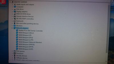

@JimM11 So i can run 300-500mbps & what about what @XRaySpeX said about device manager, network adaptor to see if it can run  it, do i need to plug brightbox out as that's capped at 100mbps to find out
[Mod edit: removed image as contains personal information]
@gazmix_1973 Yes either look at the device manager to see what device the dell reports it as, or go to the dell support site, check out the MODEL that YOU have, there are many, then look at the spec supplied with the PC, Gigabyte Ethernet has been about for well over 20 years now! Trying to find any easy guide for you, 1st one may show you!
 @JimM11 i've no idea.
Click on Realtek PCIe GBE Family Controller (same as mine) then Advanced > Speed & Duplex. Look at the Value drop-down & note the fastest, but don't change it from Auto Negotiate. In fact the 'G' of 'GBE' gives the game away.
