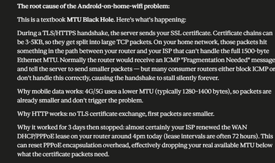

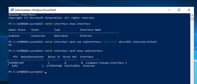

However, after ~70 hours of my website working fine, it started to fail again. I downloaded 5600 IIS logs and fed them into Claude. It suggested that an "MTU black hole"
It suggested the fix would be to lower the MTU setting on the router - but I couldn't find this setting on my SmartHub 6.  It said I could set this setting on the network adapter on the server in which my site is hosted using PowerShell.
And.. to my amazement - it just worked.
I'm fairly sure something changed in the FW somewhere as this has worked for many years and suddenly stopped.
