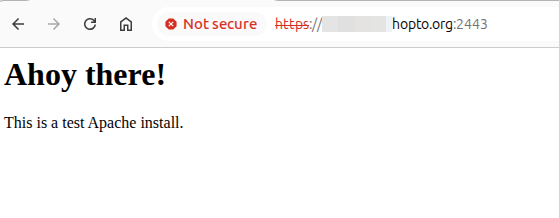

@cosbug - thanks for the detail. I've tried but failed to replicate your problem - using a Smart Hub Plus running the same r3.8.24 firmware.
From a laptop running Ubuntu 24.04.3 LTS...
I then used the Hub Manager to ensure that the 'always use this IP address' toggle was enabled for the laptop and created two port forwarding rules like this: -
Then from a machine on another Internet connection (EE mobile network in this case)...
SSH is accessible: -
> ssh [REDACTED]@[REDACTED].hopto.org -p 2222
The authenticity of host '[[REDACTED].hopto.org]:2222
([109.180.[REDACTED]]:2222)' can't be established.
ED25519 key fingerprint is
SHA256:[REDACTED].
This key is not known by any other names.
Are you sure you want to continue connecting (yes/no/[fingerprint])? yes
Warning: Permanently added '[[REDACTED].hopto.org]:2222' (ED25519) to the
list of known hosts.
[REDACTED]@[REDACTED].hopto.org's password:
Welcome to Ubuntu 24.04.3 LTS (GNU/Linux 6.8.0-87-generic x86_64)And HTTPS webserver is accessible: -
Which would suggest that the problem is likely something to do with your local environment/setup 🤔
