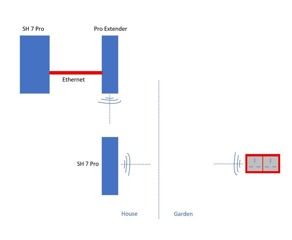

Socket is in the garden; the nearest access is via an Extender Pro
BT Home Tech run WiFi strength app on his phone and confirmed that there was plenty of signal strength at the Smart Device, especially as they simply turn on & off ..... no streaming of data.
I have 2 other Smart devices nearby (within 1m  and they connect fine)
I looked at basic WiFi app on phone it shows 2.4GHz from my standard network is a stronger signal in garden loaction than the 2.4GHz Compatability newtrok ..... whish is not what is expected.
Connection schematic is ... as per attached.

@Memnon Thanks got it all now, so again from your previous statement. Just the relevant part this true or not.

@Memnon Then it sounds like the brand off socket is either rubbish or just cannot connect to the Pro Extender, as you have a spare now, wire a cable on it and plug it in near the Extender and see what happens, if nothing take it to the Pro Hub and do it there also.
