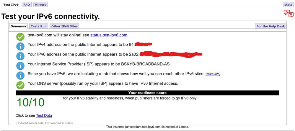

Can tell you for sure Asus works 100% no issues with /56.....
ping -4 bbc.co.uk and later ping -6 bbc.co.uk or run the whatis from earlier in the post for checks etc, ip6 test should return 10/10 and allow further checks also....

Not sure if this helps, but some of us on the Busiest Home Bundle who went through the routergate problems did experiment on going down the own router bundle.
This is what I had to do for the TP Link router i was testing at the time to get it to work. Hopefully might help someone else out there.
Note this picture is over a year old so has no bearing on my current connection or IP.
