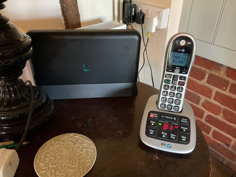

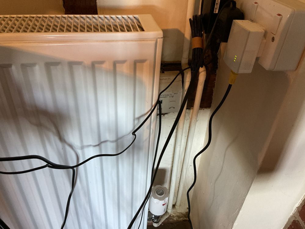

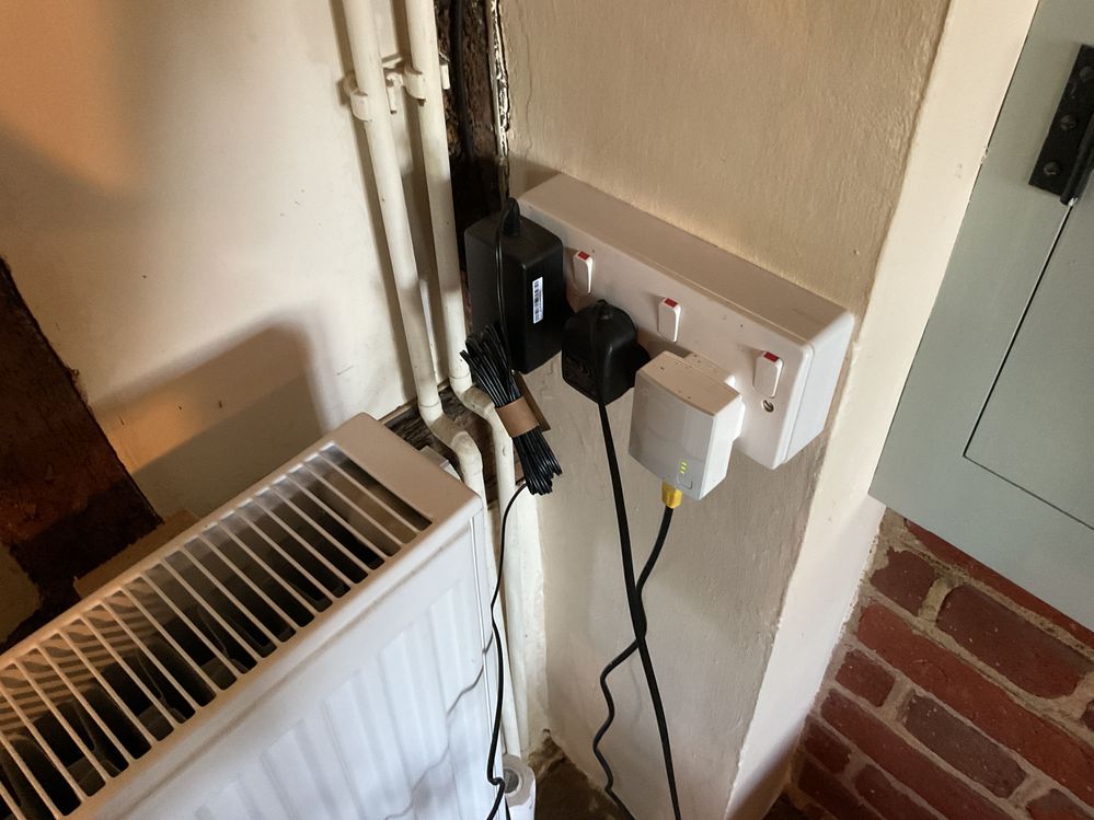

Here are pics of hub etc. thanks.
19-06-2026 11:22 AM - edited 19-06-2026 11:28 AM
@HB73 Couple off things now, you are connected to a copper FTTC/SOGEA now connection so your possible Internal wiring may be an issue, you do want to move the phone a little way away from the EE Hub, may cause wifi issues, also see that you are using powerline connection somewhere to external, i used same did not have any problems with it, the main problem with that EE Smart Hub 6+ version was the Ethernet connected response taking 20-30 second delay,
Now going to say that i re-routed my Tp-Link via a switch that i installed so cannot swear i had it hanging on the Hub Ethernet at all.....
Have a look earlier in the post, i had 6-7 Engineer visit's just due to that Hub, it HATED being on the copper connection wiring wise, but in my case, pretty sure it was the OLD GPO connection box were the main cable came in, last OR Engineer spent a lot off time as error's were on the line, directly lifted the screw connections on that old GPO termination, crimped the two wires going to that EXACT same socket arrangement you have / i had and NEVER looked back after that point.
Would also be worth a test by switching off the Powerline at the Mains socket, know it will disconnect you devices hanging on the other end, but it is only a test to see if your Hub start's to behave itself......
