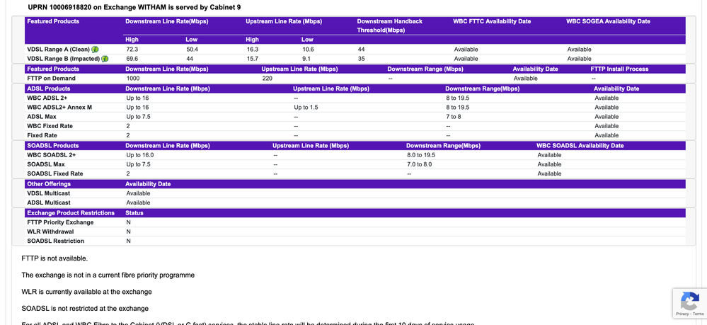

@XRaySpeX no active landline at the property so searched via UPRN. Hope it helps?
