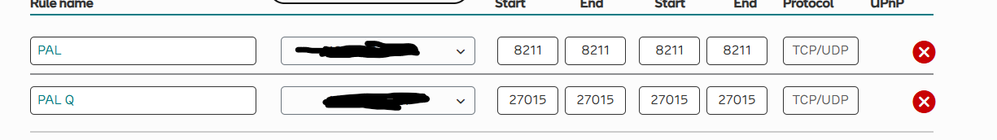

So I have port forwarded many times before with different isps for game servers tried both ark port 7777/7778 and Palworld 8211 however now that I am with EE I just can’t seem to get it working.
I have set my port forwarding rules checked that my server is setup correctly and can see they all should be working.

As Below here are the port forwards so far the PC is a static IP.
@FadeLupae Static were, in the PC itself or via the DHCP lan manager set as use this ip always? Your picture posted is not viewable until someone checks and clears it for the general viewing, just so you are aware.

@FadeLupae Thanks, will look at your posted pic when it get's cleared.👍 You can while waiting on it all, quickly throw the IP off the server in the DMZ on the hub giving the PC direct access, do your checks then pull it back out off the DMZ when finished.

@FadeLupae Picture cleared this end rules look fine as to what you have done so far!
