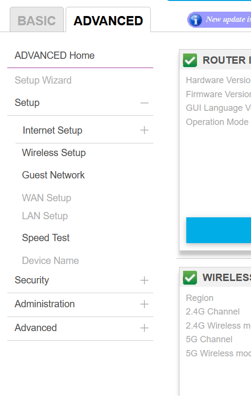

Hi JimM11,
In access point mode the WAN menu is greyed out so can't view it.
