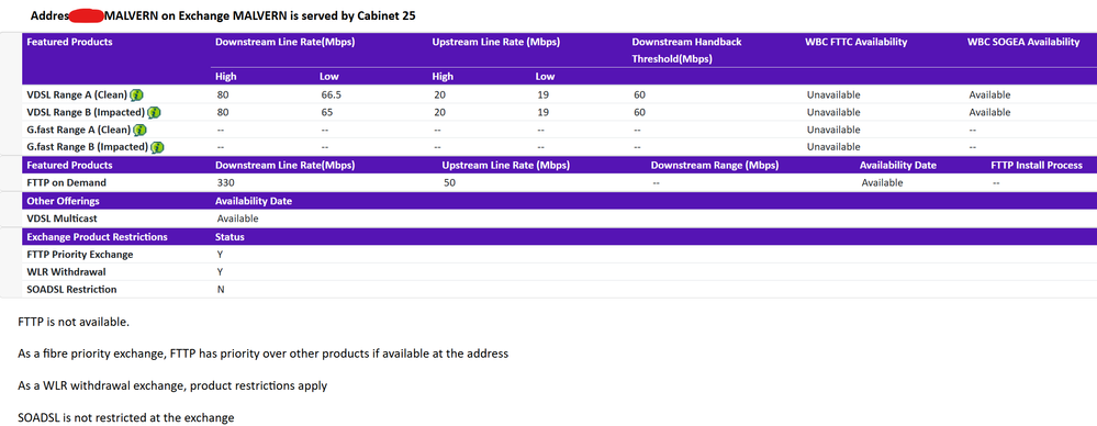

What does BT Wholesale Broadband Availability Checker > Address Checker estimate for your new address? Post the whole table, the text below it and the line above it, blanking out your address.

Yes, no FTTP there yet.
You should be offered either Fibre 67 or Fibre 74.
