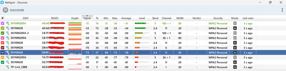

@Memnon It's EE's get out off jail option the Comp mode, so as before Turn off all the wireless wifi devices, connect the PC to the main wifi, then turn the 5Ghz on for the Comp at the WPA2-Personal, connect the PC to that node on the Hub, speed should be identical very close in the speed test range, will let you know the EE Hub is working correct, once you have established all that, bring your Extender on line then go check at the Extender location same way..... There is a LOT going on with the Method that EE does for the wifi, and without looking at it with a wifi analyzer you are really going to struggle. The Netspot from ETwok Inc PC version will allow you to look closely, just use the Free version and DO NOT pay anything at all.
Once picture gets cleared to view you will see, not everything wifi made it in as sitting close to the Asus AP doing it. Don't worry about the sky ssid name have kept it for many many years....
Netspot wifi analysis 11:00am on the 17/07/2026.Netspot wifi analysis 11:00am on the 17/07/2026.

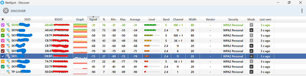

Incase EE Mods do not like the ssid name's left on without them and blanked.
Blanked the ssid'sBlanked the ssid's
