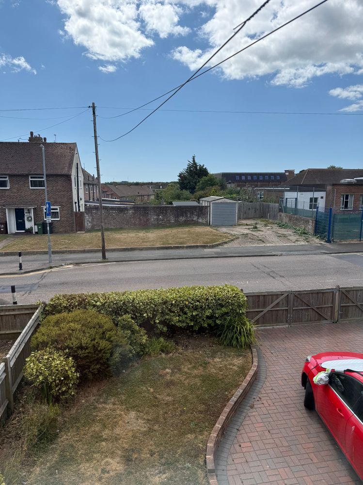

Thanks for the reply. I'm not really sure what "overhead" is with full fibre. Does that mean I could be getting either a connection from the point on the pavement outside my house or from the telephone pole across the road where my copper wire broadband comes from now? Any help would be greatly appreciated.

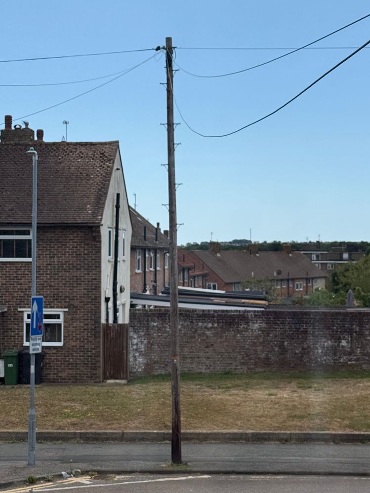

@FiestaRed , if you have copper via the pole, then they will do the same for the fibre, just new cable to the box outside your house to the box inside your house, it will be the pole as you have the copper that way, no digging up the road or garden, works exactly the same whether through the telegraph pole or underground.

The lower cable is the copper one and the upper one is the fibre.

Clicking on the BT Broadband gave me a table and the lower part of it reads:
Our records show the following FTTP network service information for these premises:-Single Dwelling Unit Residential OH Feed hoist required.
FTTP is available and a new ONT may be ordered.
"Overhead" means your BB comes from a telephone pole, but that applies to @Schockwave . Yours may be either overhead or underground. To find out, what does BT Wholesale Broadband Availability Checker > Address Checker estimate for your address? Post the whole table, the text below it and the line above it, blanking out your address.
Yes, you will get Full Fibre (FTTP) overhead (OH) from a telephone pole, just like @Schockwave , but OR eng will need to bring along a hoist.
