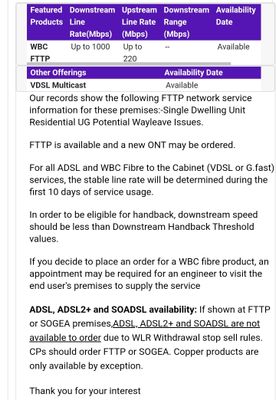

Thanks for replies. I have contacted the landlord for the communal building but I'm assuming it should be able to be kept internal from the Comms cabinets in the communal corridor. I don't think they would want boxes fixed externally so will see what they say.
I don't even know the landline number and I'm not at home right now so will double check in the morning but this is what information I get when doing it from the address information..

@Ad182   you used the mobile version of the checker, so does not show the complete table.
That said it also thinks you are in a house - single dwelling, not a block of flats, so unlikely there is any existing infrastructure available. I would guess the landlord/developers arranged for Virgin to connect the building, but not Openreach.
I suggest you will need more investigation if you want any service other than Virgin.

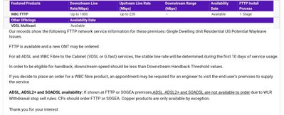

Thanks for the help so far I'm just trying to understand what a lot of it means at the minute. I just did it via desktop site and got this information. I guess I'll have to see for sure what they can do and what the building owner says.

@Ad182   The huge red flag for me is the line below the table. that thinks you are in a single house (Single Dwelling Residential)  then the bit about underground Potential Wayleave Issues, mean this is not a straight forward install, and at the very least will require a proper survey from Openreach before you get a straight answer from anyone.
Whatever you do, if you place an order, do not cancel any existing service until your new one is up and running if it is important to you, 30 days or so dual running would be a small cost to pay.
