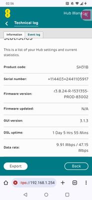

If you would like help with your BB speed or connection issues, please would you carry out the following steps for starters, which will enable us to diagnose the problem and advise you further. Do not restart your router to do these tests:
1. Post your full router stats:
  • For a SmartHub: login and go to Advanced Settings > Technical Log > Information. Obscure your names & any numbers in the BB Username & also the SSIDs. Also post the Home > Status page.
  • For a BrightBox: login and go to Advanced Settings > System > DSL Status. Also post 'System Uptime' from top of System Log page.
  • For other routers: login to it according to the label on it as the admin user & navigate looking for its router/connection statistics.
Full router stats are key to any speed & connection issues.

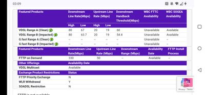

3. What does BT Wholesale Broadband Availability Checker estimate for your phone number? Post just the whole table and the line above it, blanking out your phone number. If it doesn't recognise your phone number or you don't have one, use the Address Checker, not the Postcode Checker.

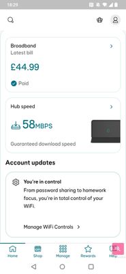

Where do you see the 58 Meg download speed guarantee?
In your online EE BB a/c > Manage broadband > Your speeds explained what does that say there?

As for the 58 Meg guarantee, I've seen it in two or three places I think, one of which is on the home
page of the EE app (attached).
Dabmonger
Established Contributor
Information

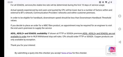

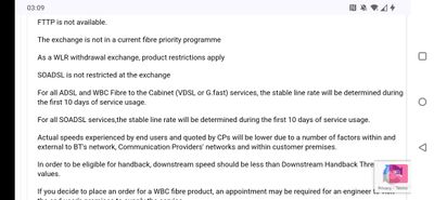

BT Wholesale Broadband Availability Checker:
Dabmonger

I look forward to hearing your thoughts @XRaySpeX .
I still like to see your online a/c's Your speeds explained before I venture an opinion.
