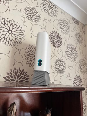

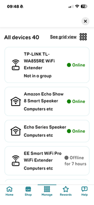

I have just switched from BT to EE - wish I hadn't!!  I have installed the Full 900  Ultimate with the extender hub. The extender will not pair with the hub (accord to the app)  or show up as connected on the app. BUT - the Aqua light is showing. How can I tell if it is working properly? I have reset both hubs twice to try the pairing. Also my app says I have 40 devices connected, but most are duplicates? Awful app - very user unfriendly . I saw a pic on here from the app that showed how everything was connected but I cannot seem to find that on my app, so perhaps it has been upgraded?

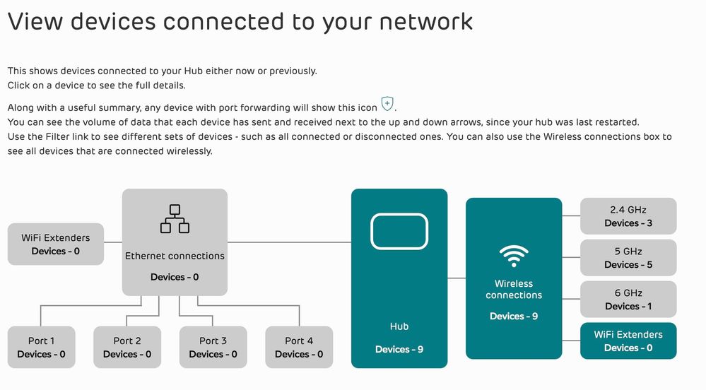

@BarryH2 Just use the web manager to look at everything, and NOT rely on a app to display it to you! There are other tools in the tool box, http://192.168.1.254 to get to the Router Web Manager.

That's great - thank you. This what is shows - I know it won't show the TP-Link extenders, but I know they are working. Surely it should show the extender hub?

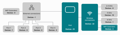

I just installed my extender and I was a little confused by this. Extender wasn't showing in the web screen despite the solid aqua light on the extender.
When I looked a little later, and I had 3 extenders! Strange. Then I realised, that screen doesn't show the number of WIFI extenders attached, it show the number of devices attached to an extender !

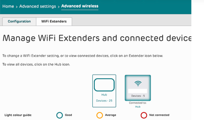

I finally found the page that shows the status of the extenders and which ones are connected.
