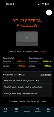

For the past couple of weeks I've noticed my download speeds dropping significantly during evening peak hours around 6-10pm ish.
I pay for the 1600 Mbps service with a minimum guaranteed 1300 Mbps speed.
I've logged speedtest results for the past couple of weeks so I can prove when the speeds are dropping.
When I do the test nobody else is on the network, it's tested hardwired on a 2.5Gbe connection high quality Cat 6 cable approximately 4m away from the router.
I've spoken to EE support a few times and they basically say everything looks fine their end and an engineer is coming out tomorrow lunch time.
Because it's not the peak time it'll work fine.  How do I approach this to try and get a fix?

I’ve just done the EE app test and it’s showing as slow. Now the biggest drops are during the weekdays not the weekend but it’s still way below my minimum guaranteed speed of 1300mbps.
@Spyder99 Will take a look once your picture gets approved for viewing!
@Spyder99 Indeed your app is showing what is required now for EE, a call to EE CS is what you need to do!
Would also point out to you that the system thinks you are supplied with a EE Smarthub+ Router and NOT a EE Smart Pro system for your app connection! Picture is wrong in showing you the connected device!

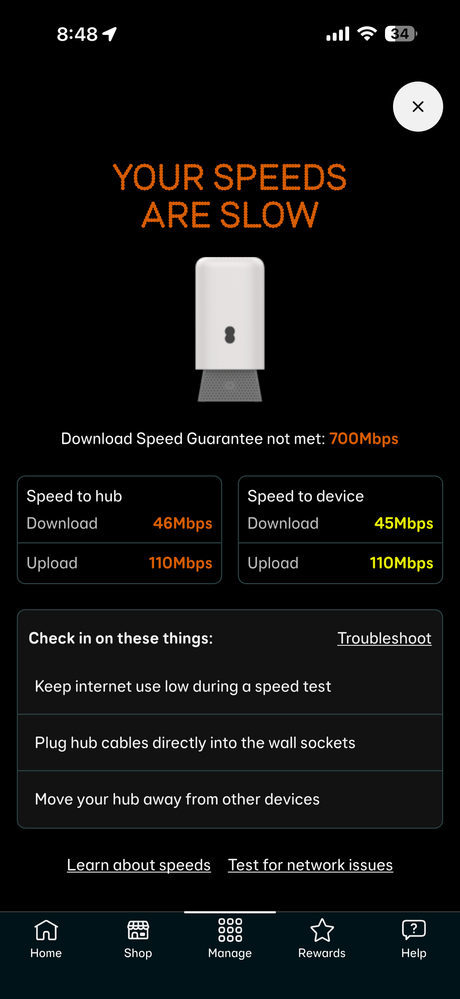

I get a similar issue in evenings, occurring only in last few weeks
with speeds as low as 40mb/shown on a 900mbs link
at the time of congestion, Openreach see no issues on fibre (exchange test to ONT got 980mb/s, EE app got 74mb/s)
looks like EE may have congestion issues in their network
ONT and Router replaced, now awaiting EE/OR to investigate further

No porkies , it’s all on EE, the issue occurs in evenings only (see screenshot for evening speeds)
OR changed ONT to rule that out
EE then wanted to do a cease and reprovide (which would do nothing physically) which would take a week+ (with no internet)
so another OR engineer was sent
a replacement router was then sent out, same issues
I’m now spinning, trying to get them to fix the issue (or even look at the cause for evening slowness)
Each call to EE seems to be 3 steps back …..
