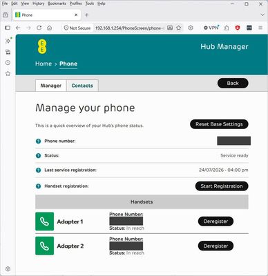

Update: the two corded phones connected via EE Wifi home phone adapters have been re-registered for around 48 hours, but still neither extension phone works (the corded phone connected via the EE router/Smart Hub 6 works OK). The router handsets/adapter information page is also attached.
Both EE Wifi home phone adapters show a continuous green light, which strikes me as counter-intuitive for a non-fully-functioning piece of equipment.
The broadband switch from Plusnet to EE occurred on 24 June 2026.EE Hub Manager - 2 Extension phones registered but not functioning - 24 Jul 2026.jpg

Think the web manager shows status off the DVA's when connected in the system you may just have to take a look at them, https://192.168.1.254 to get to the EE Hub. will be under the phone connected details i think. This link below also leads to the user manual if you need it.
Set up and use a Digital Home Phone Adapter | Home Phone Help | EE
@Dave523 Your posted picture was not available at the time when reply was sent, but they sure look like assigned to the Dect side of the EE Hub, can only suggest now you power off the Hub for five minutes and when it's back on and Aqua again see if the DVA's play ball with the phones.

Many thanks - switching off/on the hub/router seems to have rectified the problem, so both extension phones function as expected.
I also phoned EE Technical Support prior to your message, who suggested replacing the nearest Wifi home phone adapter (for the Tempo III Betacom; maybe a faulty adapter and possible signal conflict with the other adapter). This I did, but both adapters tried with the Tempo III Betacom work fine after the router switch off/on.
@Dave523 Only true suggestion i can help with is just keep an eye on it at all times, this DV operation Hubs/DVA's is kind off temperamental in general operation, and the Hub off - on with some time for the power decay just seems to be the get out off jail card with it all.😂👍👍
