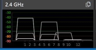

No, @JimM11 , you do some maths. Negative nos. go downwards, or smaller, as the no. w/oiut the minus gets bigger. Have a look at some graphs.Capture.JPG
 -90 is down, not up.
