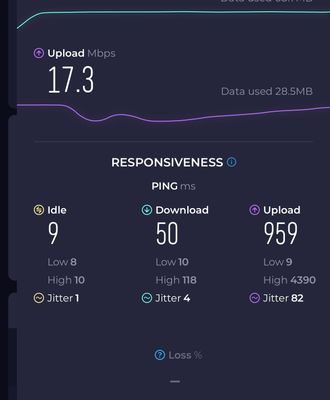

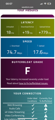

I have been moved from bt to ee and the upload lag ping for gaming is like 3k jitter.

but look at the images ive attached. Clearly shows major issue. I’ve had open reach out and said they cant see issue.

Looks like you may be on a fttc copper connection running into a OR Master Phone socket. Run the speed test below, think you are going to see packet loss and also very poor upload control on the line! Test is very detailed....
https://speed.cloudflare.com/
