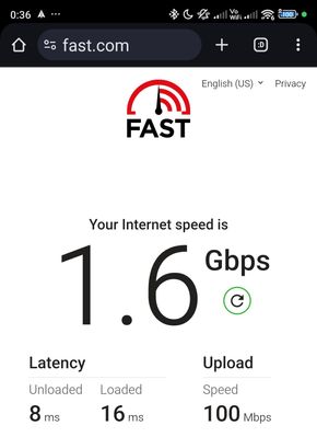

09-03-2024 11:06 PM
To be fair, WiFi on EE SH+ (2023) is capable to do 1.3 to 1.4 Gbps in best condition, but most of the time You will see 1.3 as Max...
Wiring on 1 Gbps it's very very bad move, especially you trying to sell it as 1.6 Gbps package...
I am running on TP-LINK Omada (third party) system and have normally (after few tweaks here and there) now perfectly fine this:
Shame as you need invest to third party equipment to benefit from full speed on LAN or WiFi ...
